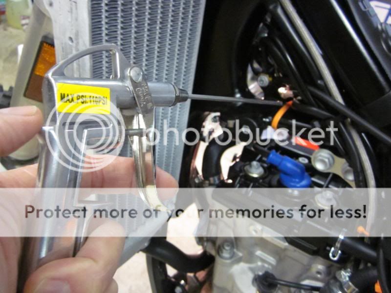

2) Use compressed air to blow away any loose dirt/dust .... and seal off anything else that you might have exposed:
TIP: Be sure to get up, and around all the cables running along your top frame member.
You'll think you have everything clean ... and then halfway through your valve adjust, you'll move two cables apart ... and a "little shower of dirt and crap" will rain gently down onto your exposed and oily camshafts.
And that's "bad .... mmm-m-kay?"
So wiggle and move the cables and wiring above your valve cover and spray compressed air at them. That'll get most of it.
As a last step, I spray some Windex or isopropyl rubbing alcohol onto a paper towel and wipe around the valve cover gasket.

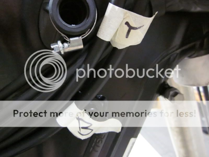

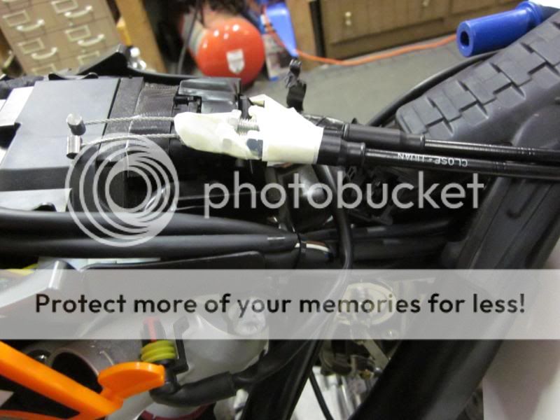

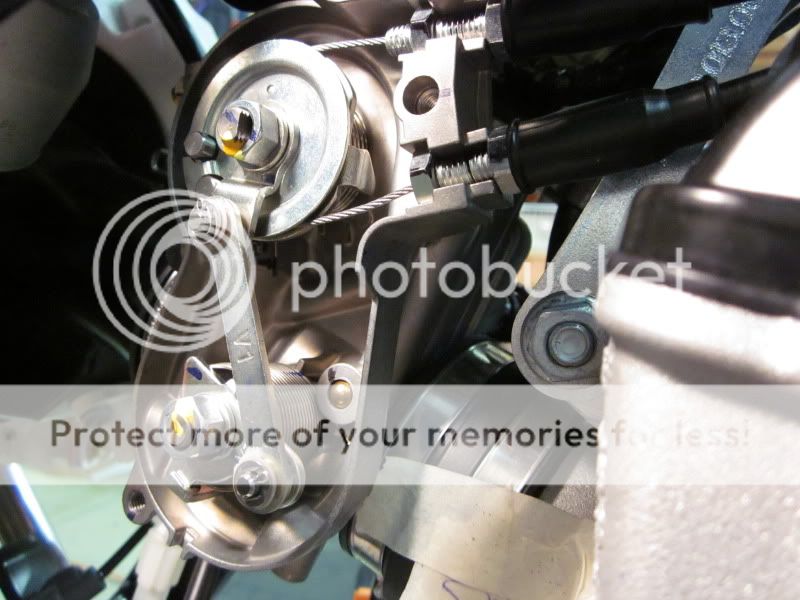

3) Unbolt your throttle cables from the fuel-injection throttle body.
You'll need a 4mm Allen wrench for the throttle body cover and 8mm and 10mm open-end wrenches for the locknuts and adjustment barrels.
TIP: Before loosening the jamb nuts on the throttle cables:
== Take some masking tape and mark the "Top" cable and "Bottom" cable.
Once again, this helps with routing and speeds up reassembly.
TIP: Use a magic marker and make a line down the edge of the adjustment barrel, the cable ferrule (the metal body at the end of the cable), and the nut on the inside of the throttle body.
This will help maintain your adjustment/alignment and speed up installing them back in.

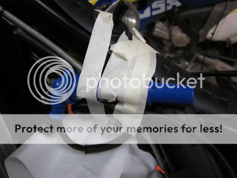

Put on a strip of masking tape holding the securing nuts and the adjustment ferrules so the nuts won't spin.
Once again, it keeps everything lined up and greatly speeds up reassembly.
Then tape and secure the throttle cables up and out of your way:

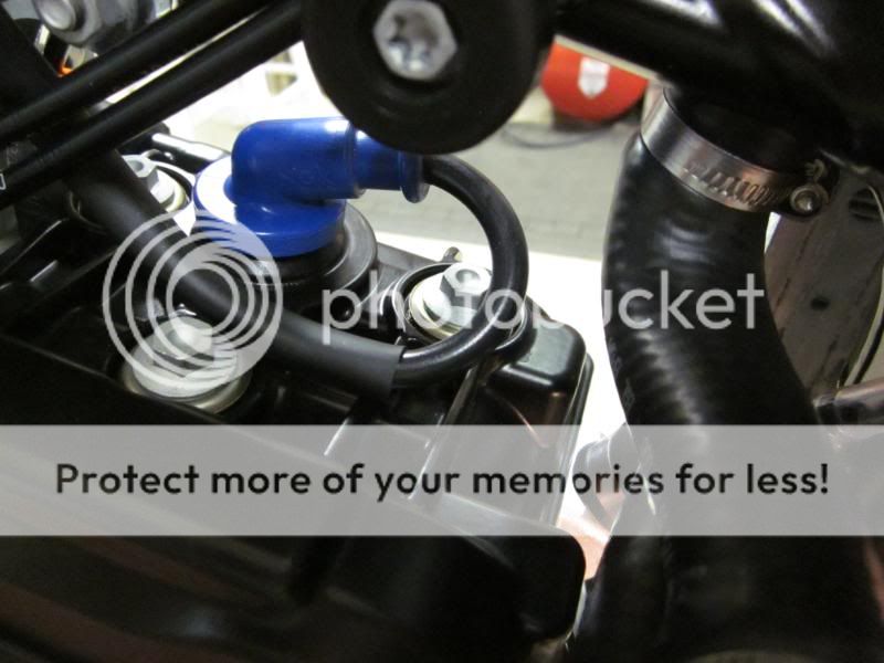

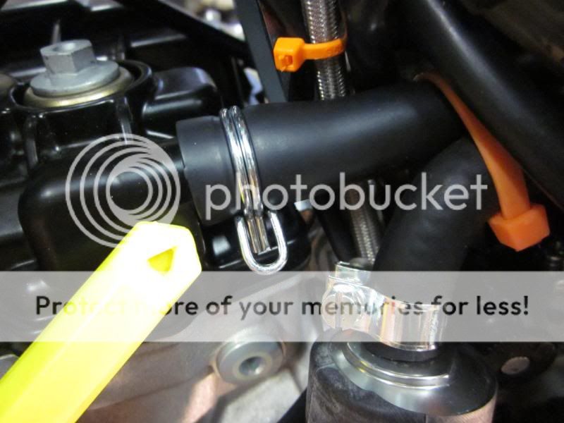

Removing the spark plug

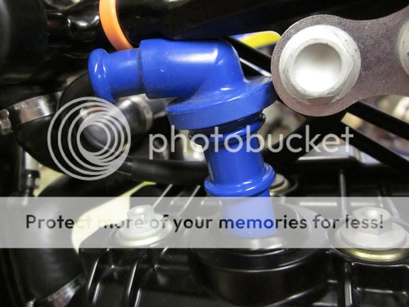

4) Remove the vent hose from the valve cover.
And while you have it off ... inspect what's inside of it. Water/moisture? Oil? A little? A lot?
Remember, you're trying to get a feel of how things are *now* ... so that you can spot if things are going wonky at a later date.
A very small amount of oil or oily smooge is normal.

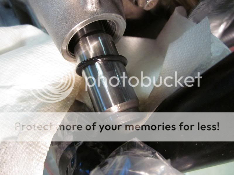

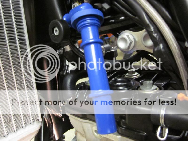

5) Pull off the sparkplug cap. (note the orientation/routing of the spark plug cable before starting.)
WARNING! Do NOT pull on the spark plug wire itself!
If you're not careful, you can pull it right out of the spark plug cap or make an intermittent connection.
ALWAYS lift and pull on just the cap itself!
Now gently ... but firmly pull straight up on the spark plug boot:
Well ... crap.
Okay, Fritzie ... who designed/okay'd the limited clearance between the spark plug cap and the top frame member?
TIP: To help it slide by, I wiped on a little dab of silicon spray on the frame where it contacted the spark plug cap.
NOTE: The second time that I removed the spark plug cap I found that I had more clearance by pulling the spark plug cap out the *right-hand* side of the frame cross-member.
WHOLEY CRAP ....!!! So just how long is this puppy!!!
Good lawd. By my rough calculations ... the spark plug is located just below the piston and just above the crankshaft.
Secure the spark plug cap to the frame with some masking tape so it doesn't "boing!" back in the way in the middle of your valve check.

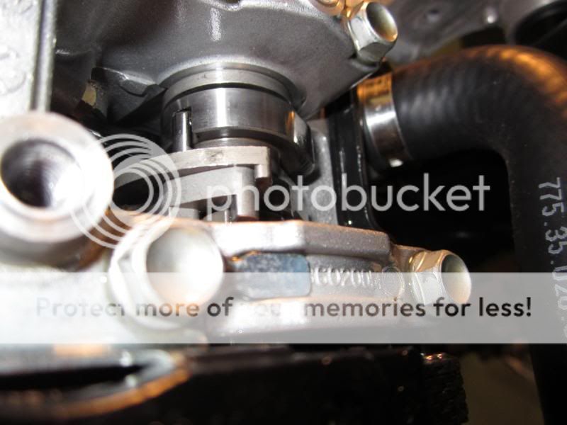

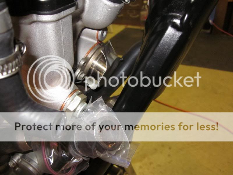

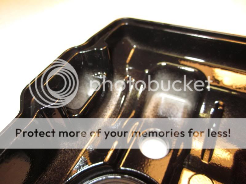

6) Undo the three bolts and remove the valve cover.

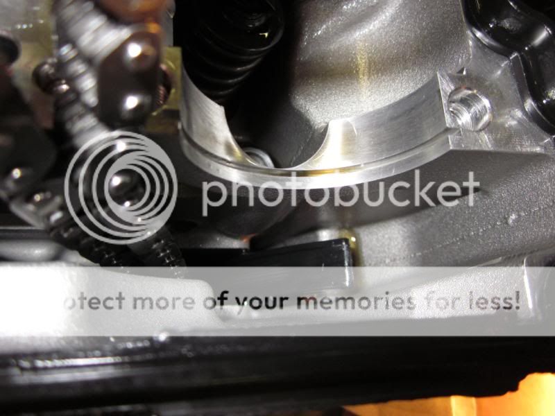

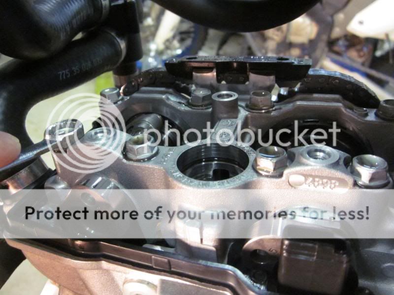

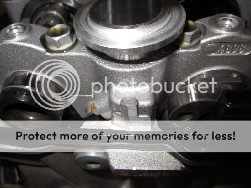

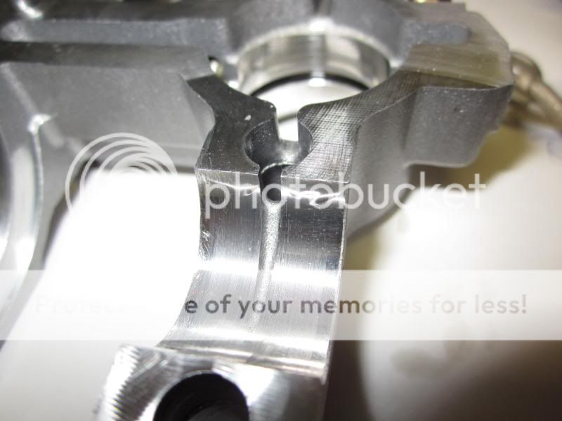

NOTE! The valve cover gasket is supposed to stay with the valve cover.
The half-round plugs are sealed to the head with a light film of Loc-Tite 5910 Sealing Compound to keep them from leaking.
However, when I lifted off my valve cover ... the gasket stayed with the head.
So I just slowly lifted the valve cover straight up and gently separated the valve cover from the it's sealing gasket.
Look at the following picture and you can see that how the gasket rounds are sealed into the camshaft cutouts.
Next time I may make sure the valve cover gasket stays with the valve cover when I remove it.
You also need to lift the valve cover straight up so that it clears the plastic tower for the vent hose:

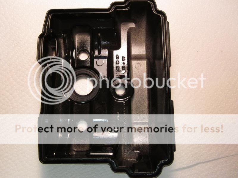

Here is the bottom of the valve cover.
This shows the chamber for the plastic sleeve that connects to the vent hose:

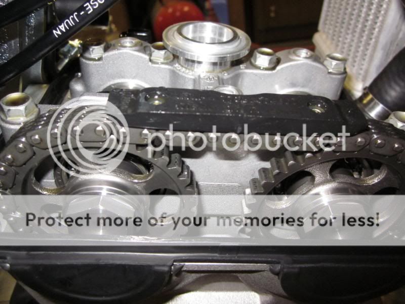

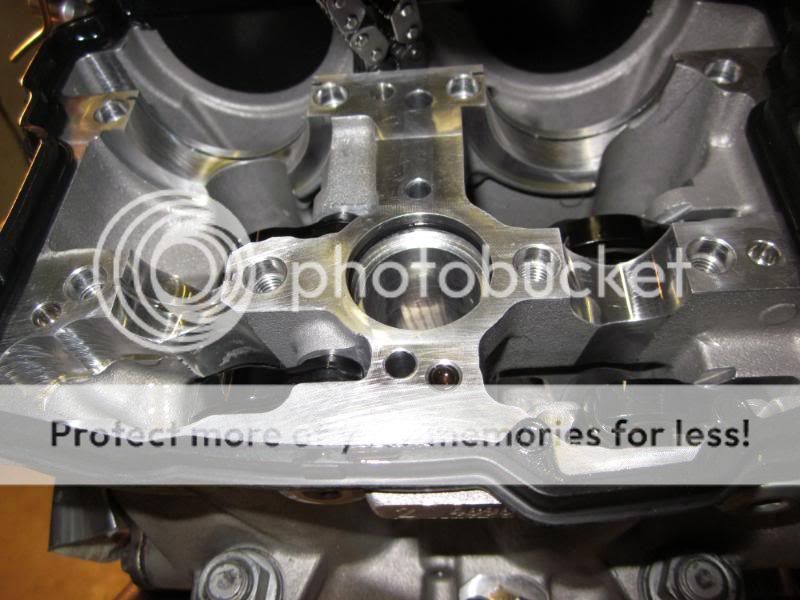

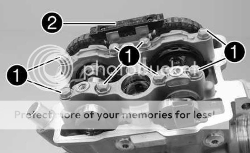

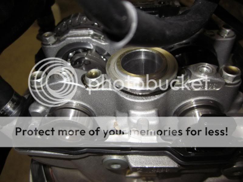

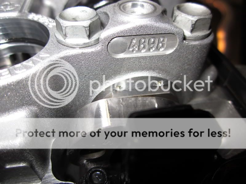

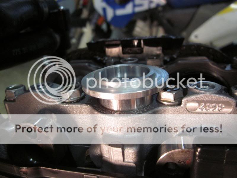

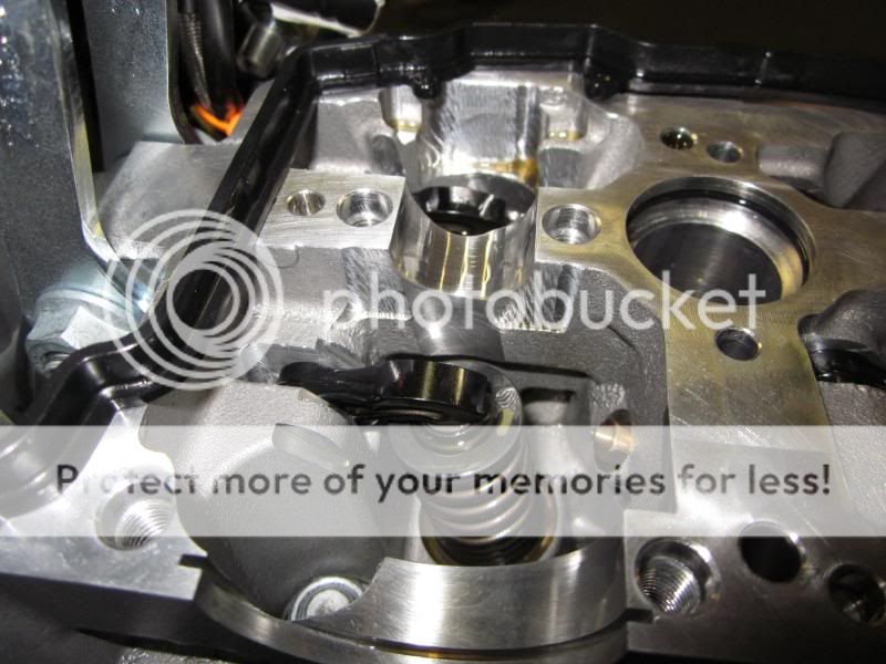

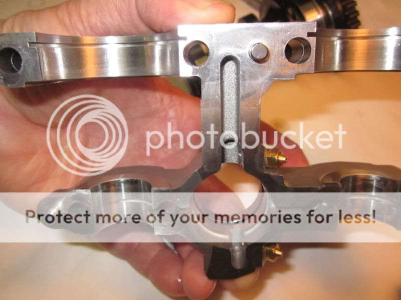

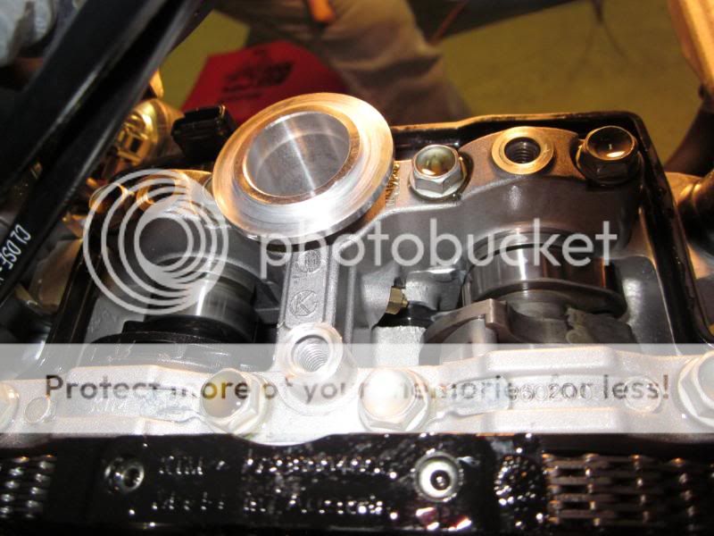

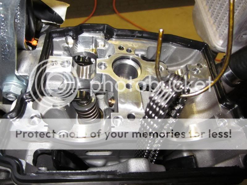

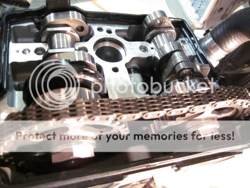

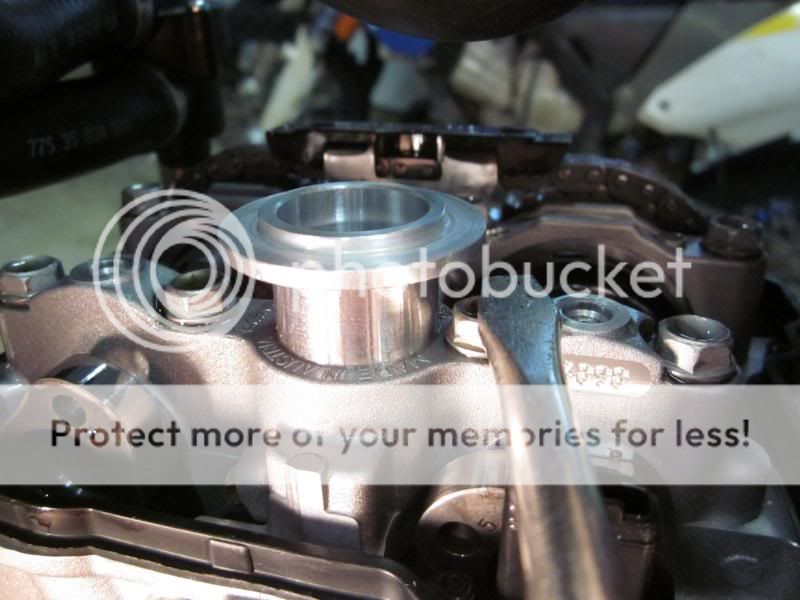

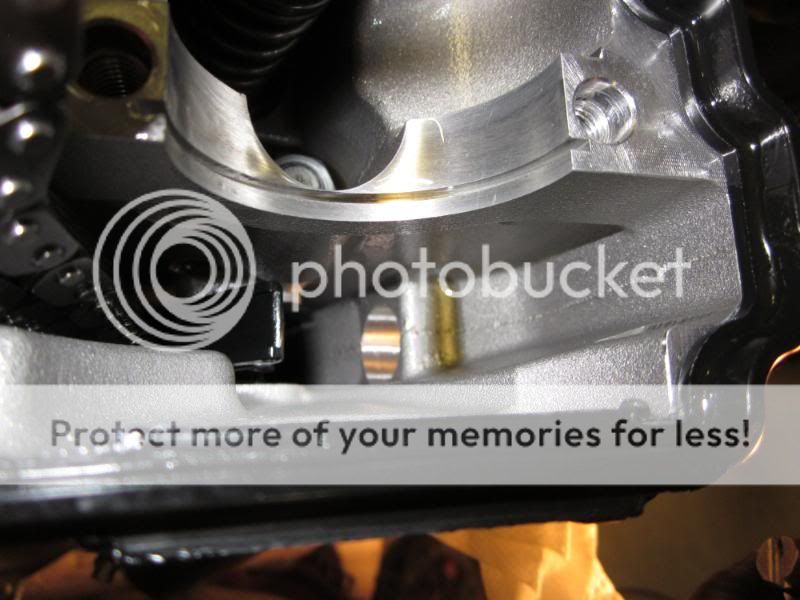

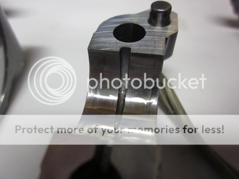

And here's where all the magic happens ...
[Editors Note: E-Ticket is lost in thoughtful gaze staring at all the complexity and wonder of a state-of-the-art twin-cam motor.]
Wholey ... crap! :shock:
Man, this doesn't look near as fun as working on the single overhead cam (SOHC) like on my Hooseyburger FE 390. acckk.
Oh well, I knew the job was dangerous when I took it. (grin)

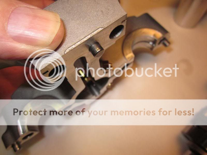

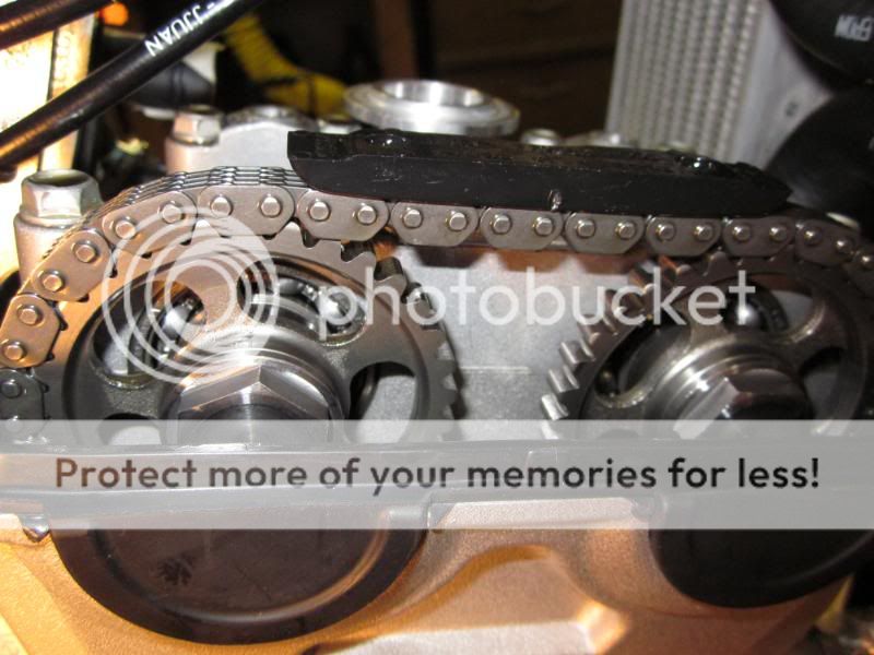

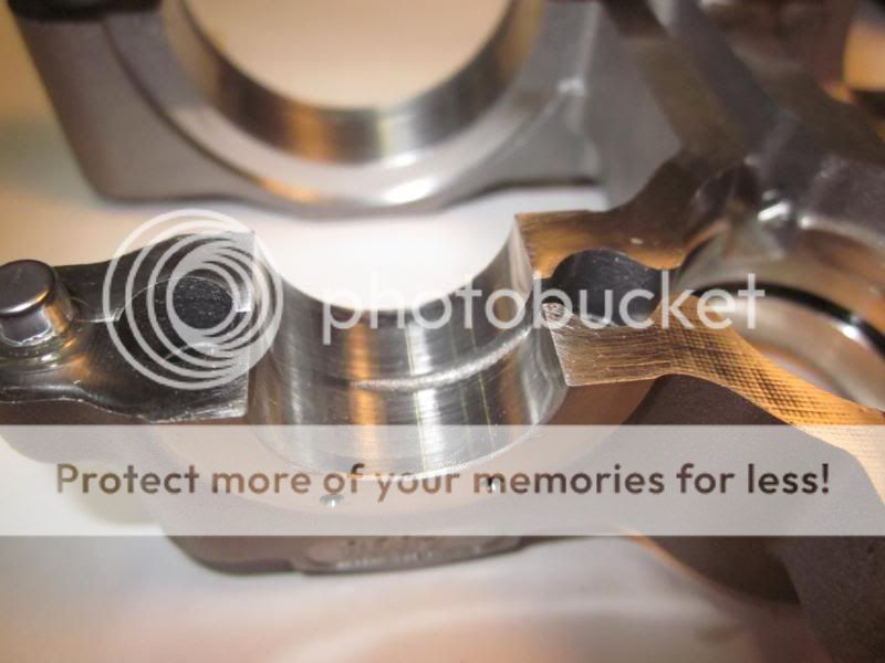

Various shots of the valve train:
Close-up of the automatic decompressor (ADC) unit on the right-hand exhaust cam lobe.
You can see where the "bump" shaft rotates out and just barely cracks open the exhaust valve, slightly lowering
the compression, which allows the engine to spin easier as it approaches top dead center (TDC).
After the engine starts, the camshaft spins faster, and centrifugal force rotates the ADC counterweight ....
which in turn ... rotates the bump shaft to a "closed" position and it no longer sticks up.
A small hair spring keeps the ADC in the open position when the engine is just starting.
A close-up of the cam lobe and the valve follower just below it.
The cam lobe pushes on the valve follower "finger" ... which then presses on the valve adjustment
shim ... which rests on top of the valve stem ... nestled in the valve spring retainer.
So. Clear as mud ... right? lol.
The brass thing right pointing at the cam lobe is the oil jet which sprays oil directly on the face of the cam lobe and the valve lever.
The black rubber piece on top is simply a guide rail for the cam chain to keep it lined up and not whipping around.
Which is required for the 350 motor to be able to hit 12,000 rpm. :ride:

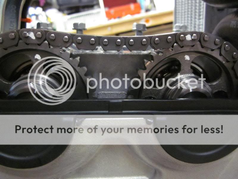

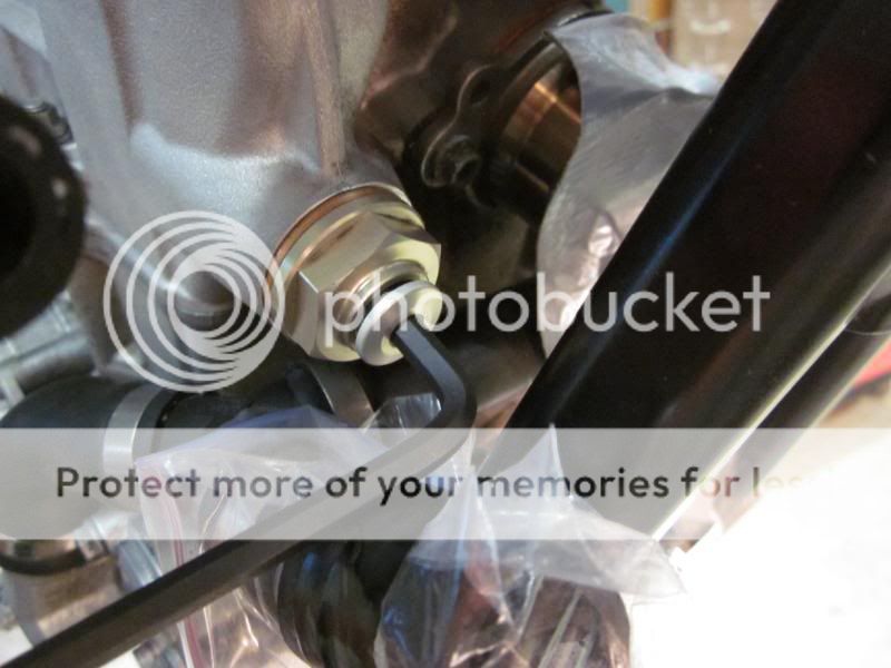

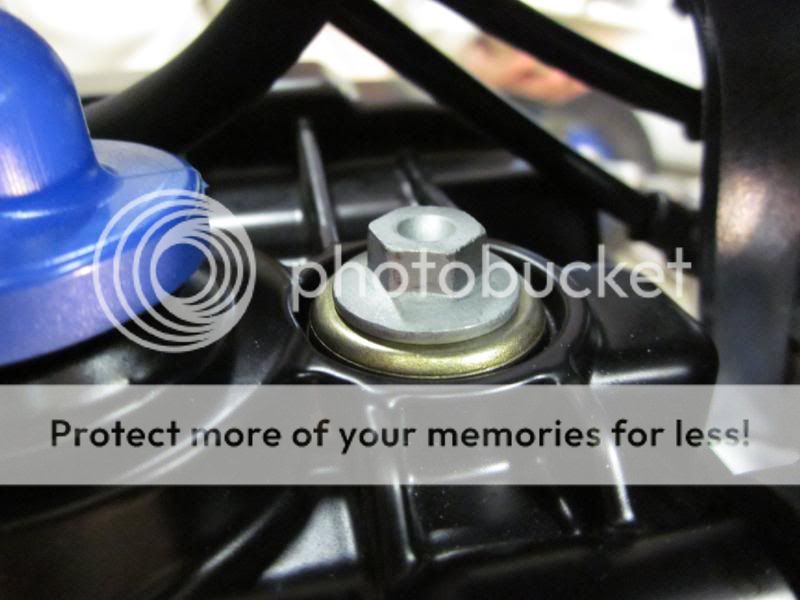

Setting Top Dead Center (TDC)

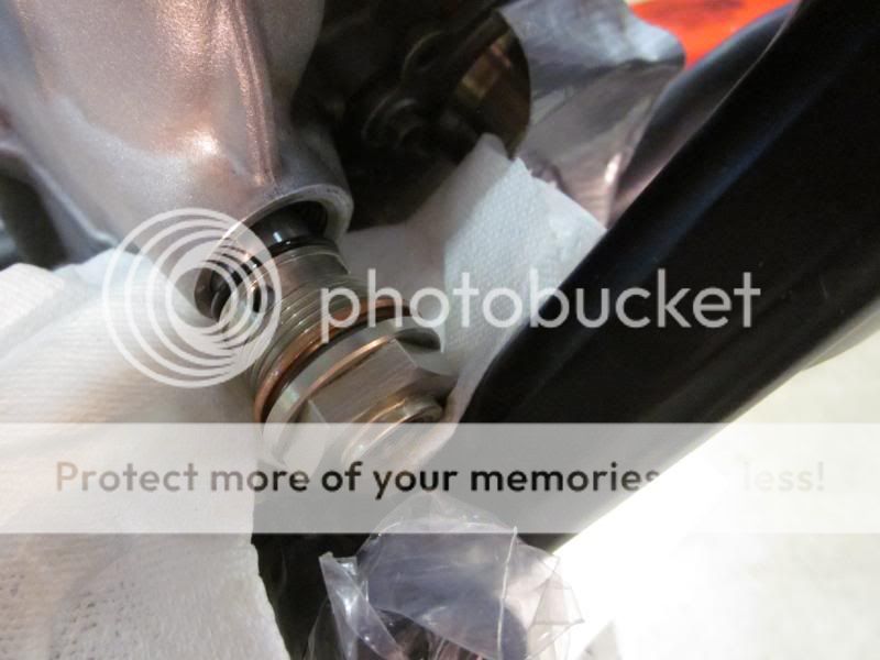

7) Using a 6mm allen wrench, remove the crankshaft "fixing" bolt and it's copper washer.
The bolt is located on the lower right-hand side of the engine ... just in front of the brake pedal.
This is the bolt that we will re-insert -- WITHOUT the copper washer -- after we set the engine at ignition TDC.

When the flat spots on BOTH camshafts ... line up so they are aligned with ALL FOUR dimple marks on the head ... you are at TDC.
That is, you should be able to just see all four dimple marks ... evenly.
The following pic shows intake camshaft's flat-spot/dimple mark alignment:
The following pic shows exhaust camshaft's flat-spot/dimple mark alignment:
9) Remove the copper washer from the crankshaft fixing bolt and insert the bolt back into it's hole in the case.
The bolt should screw in and bottom out *EASILY.*
If you're having to force the last little bit -- you're not at exact TDC. Gently tighten the bolt.
This will lock the crankshaft in place so that it cannot move during your valve check/adjustment.

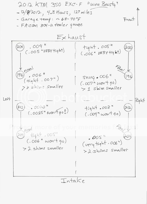

Okay, so I just did all my clearance checks .... and WTH ...??!!! :shock:
*ALL* of them are out of spec. and *WAY* too tight!
Left Exhaust: .004"
Right Exhaust: .005" (very tight)
Left Intake: .002"
Right Intake: .003"
So, it looks like my being slightly paranoid actually did pay off! And yes, I rechecked them a bunch of times.
I even had the Flying Ant check them as well just to be sure that I wasn't smoking dope.
Boy .... I bet it runs better after I get the valves adjusted, eh?
Wow.
Well, it looks like I now get to show you how to pull your cams and change your valve shims! lol.
12) Record all of your valve clearances on your record sheet.
Leave yourself plenty of room for recording your current valve clearances, your shim sizes, *and* your final clearances.
Here is my (final) copy:

Removing the spark plug shaft insert
13) IMPORTANT! Verify that your crankshaft is at TDC and LOCKED in place using the crankshaft fixing bolt.
...............(See Step 9.)
This is critical! If you do not lock the crankshaft in place, you run the danger of valve spring pressure advancing the camshafts once you loosen the cam chain tensioner (CCT).
And that would be bad .... m--m-kay-y-y?
14) Remove the sparkplug shaft insert.
(TIP): The insert fits very closely and tightly into the cam bridge. Lift it up very slowly while keeping it "square" in it's bore.
You can use a pair of "clean," big, flat-blade screwdrivers to gently pry upwards until you get the insert moving.
Proceed slowly and carefully! All of these items are soft, easily scratched/warped aluminum.
15) Start setting your top-end parts on your clean work surface.
You do have a clean work surface ... don't you? (grin) I prefer to use a new, big piece of butcher block paper.
You can write on it ... dirt shows up easy ... and it doesn't have loose paper fibers to get on your oily camshafts.
After removing the spark plug shaft insert.
TIP: Use some contact cleaner and clean the oil off the following spots on the camshaft gears and timing chain.
Using a *VERY* small amount .... put a small dab of white-out on these locations.
When you re-install the camshafts -- you engage them with the timing chain and kind of "roll" them into place.
These registration marks are a huge help in lining up the correct orientation between the camshafts and the cam chain.
But do be careful and don't knock off any of the dried white-out into your cam chain tower!
And also make yourself a note to CLEAN OFF the white-out before re-installing the valve cover!! Ask me how I know. (grin)

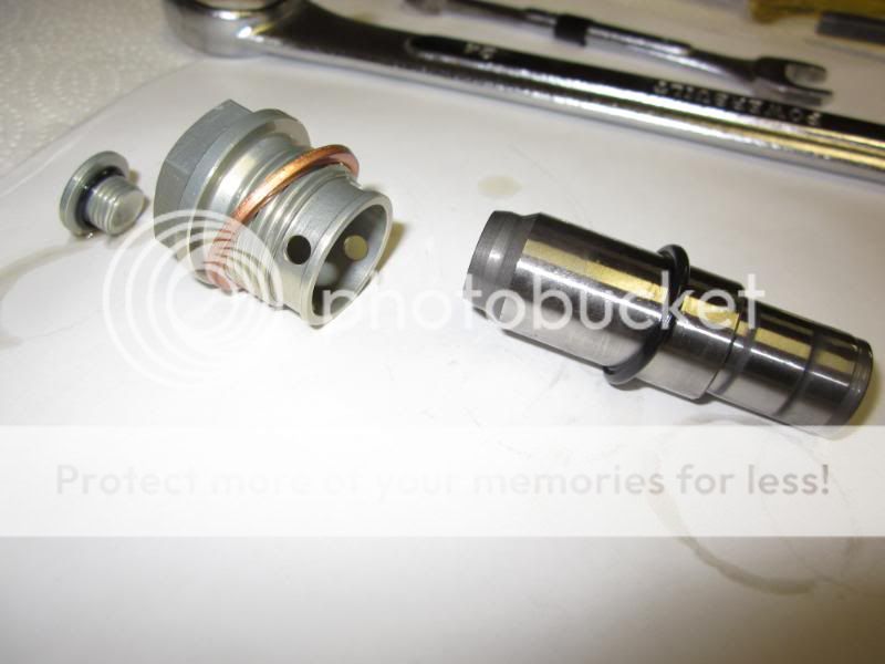

Removing the cam chain tensioner (CCT)
16) Using a 5mm Allen wrench, remove the small cap on the outside of the cam chain tensioner (CCT)
17) Using a 24mm box-end wrench, loosen the main cap over the CCT.
18) Unscrew and remove the main cap. A small amount of oil will come out with it -- this is normal.
19) Remove the CCT ... it should just slide out.
NOTE: A large o-ring should come out as well. If it doesn't, reach in carefully with your finger and pull it out.
Here's is what the CCT, o-ring location, and the locking caps should look like:
TIP: When ever you lay something "round" on your work bench --- orient it so that if it rolls anywhere -- it won't roll off the bench and onto the floor.
Your cam chain will have some slack in it and will probably look like this:

Removing the cam bridge
21) Using a 10mm wrench/socket, loosen the bolts securing the cam bridge.
Important! Loosen the bolts ... a little a time .... in a star-shaped pattern ... starting with the outside bolts and heading inward.
This loosening method is used to avoid warping or binding the aluminum cam bridge.
Start with the outer-front left bolt, then the outer-right-back, then outer-front-right, and then outer-back-left bolt.
Follow that sequence with a small turn on the inner four bolts ... using the same star-shaped pattern.
Then repeat again for the outer four bolts, and etc., etc., etc.
Continue using this loosening pattern until all eight cam bridge bolts (#1 shown below) are loose.
22) Remove the eight bolts and the guide rail (#2 shown above).
23) Lifting STRAIGHT UP ... slowly and cautiously remove the cam bridge.

Here is a view of the bottom of the cam bridge.
The left side of the camshafts bearings actually ride directly in the surface of the cam bridge and the head.
These are referred to as a "plain bearings." IMPORTANT! Do not scar or scratch up these surfaces!
The right side of the camshafts uses typical roller bearings.
The milled slots in the bearing saddles locate the camshaft roller bearings and keep the camshafts from traveling left and right in the head.
The brass "squirty" things are your oil jets. It's a good idea to blow those out with compressed air to make sure they're clear. You can see the oil passages here as well.
Here are some close-ups of the plain bearing "shells" in the cam bridge.
Be sure to inspect them for any discoloration, damage, etc..
Those small holes on the side are the "dimple marks" used for setting TDC on the camshafts:
And a couple of pics of the top of the head and the camshafts.
Note the "flat spots" on the camshafts that are used to find TDC and for registering the cam gears (when they are removed).

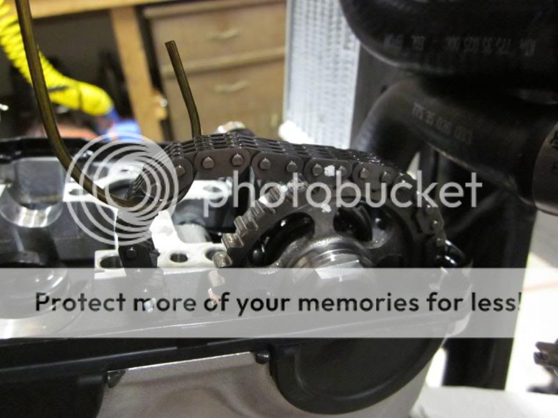

24) Prepare a piece of wire for securing your cam chain (so that it doesn't fall down in the cam chain tower after removing the camshafts.)
25) Lift off the cam chain and carefully/slowly lift up and remove the INTAKE camshaft.
You may need to tilt the camshaft slightly to accomplish this.
Be CAREFUL and don't scratch up the cam lobes or bearing journals.
TIP: Find a patient helper to assist with removing the cams and holding the cam chain! It really does help. :^)
26) Hang the cam chain on your "hanger." (Which is what I used ... a portion of an old, bent coat hanger.)
27) You can now remove the exhaust camshaft.
NOTE: There is a guide plate on the lower crankshaft gear so that the cam chain can't come off.
But you definitely don't want to drop the cam chain down the cam chain tower and have it get wadded up and caught somewhere.
REMEMBER to set your camshafts so that they can't roll off your workbench!

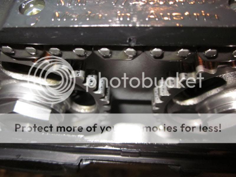

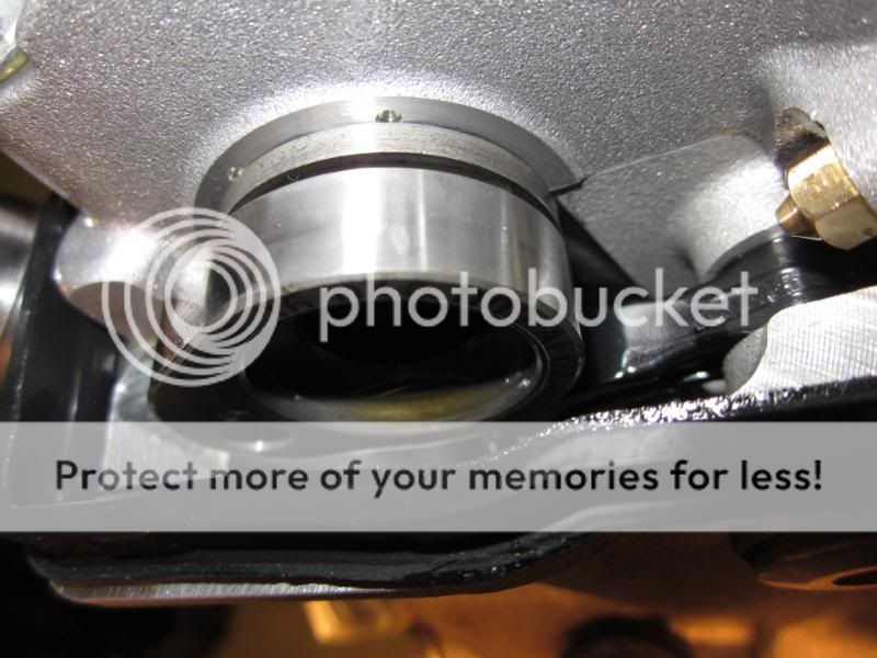

Here are some views of the top of the head, the valve levers, and valve spring assemblies:
Looking down the cam chain tower (...er ... "hole?" ... <g>) you can see the black, chain guide bar.
It is plastic-coated aluminum.
This pic shows the chain guide pushed rear-ward.
You can also see the round hole where the CCT comes through and presses against the chain guide bar.
And the view from the left side of the engine.
If you squint your eyes *just* so ... you can see the reflection of the spark plug another 4 feet down that hole.
Geez ..... could they have made it any more inaccessible?
